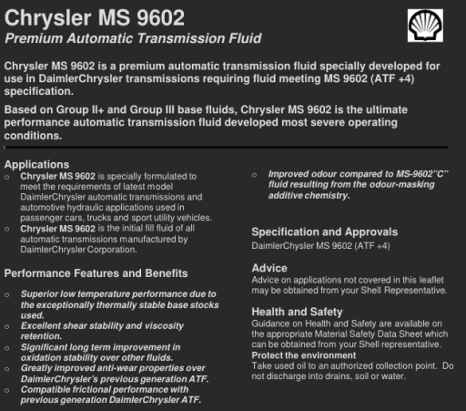

The 6-speed is the 62TE transaxle. The 4-speed is the 41TE.
Both use ATF+4 fluid meeting Chrysler MS-9602 (MS=material standard).
Use of any other types of ATF can damage the clutch elements.
The filter is accessible once the bottom pan is removed.
Replace the rubber cooler hoses if they are leaking.
.png Screen Shot 2023-09-14 at 12.10.30.png Розмір: 158.18 кб  Завантажень: 228
.png Screen Shot 2023-09-14 at 12.14.35.png Розмір: 31.65 кб  Завантажень: 229
